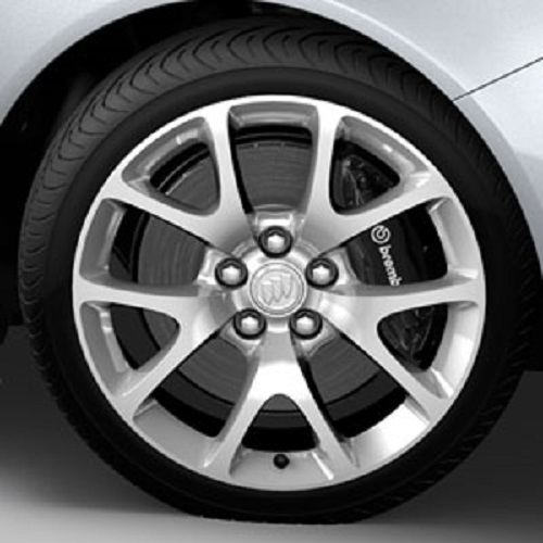

could have been mis-labeled, but I suspect the real issue is that for the production application (FWD Regal), the calipers are in "lead" - forward of axle centerline, so the caliper (as marked) would be correct for that vehicle.
Here's a picture of a wheel on a Regal, showing the RF, caliper forward/lead position.
https://s3.amazonaws.com/rp-part-images ... 2375ec.gif
