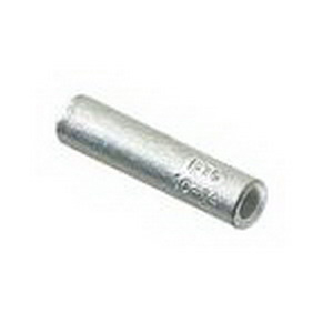

And just for guidance on the kind of connectors to use to splice into the wire. The best technique I have found is to use a bare butt connector along with adhesive lined shrink tubing. Cut the factory wire, strip backs the three wires you will now join. Install a 2 inch length of shrink tubing down the wire. Install 2 wires on one end of the butt and crimp, crimp the other wire in to the other end of the butt. move the shrink tube over the butt connector. Heat till adhesive oozes out each end. Nestle the connection back in the main harness and tape around the area. That is a connection that will be trouble free.
Bare butt connector:
Will want one that can fit the factory wire (looks like it is about 18AWG) plus what ever wire you are using for your repeater. Since it is an LED you barely need anything big. Maybe 20AWG at the most.
Adhesive lined Shrink tubing. Just get some that is a little bigger than the butt connector.
