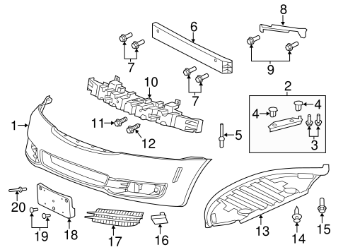

If anyone added fog lights and would not mind selling their original, non-fog light left bumper cover insert (number 17 shown below), I'd like to buy it. Please let me know.
