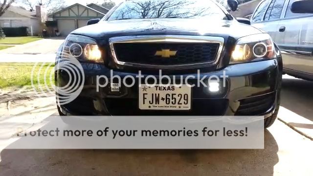

I did mine a while back. My LEDs are connected to my high beams, so they flash, too. Hard to tell, but the left LED is wired to the right high beam, and vice versa. The quickness of the LEDs makes it hard to tell.
http://vid6.photobucket.com/albums/y211 ... ndgmiy.mp4
